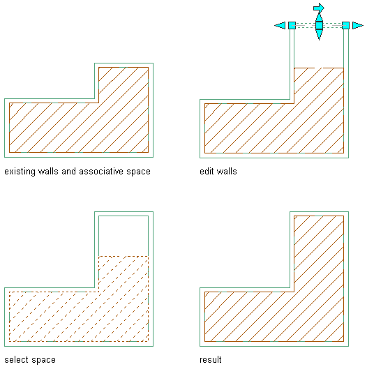

You can choose to either update only selected spaces, or all associative spaces in the drawing.
A manual update can be necessary in these cases:
  • The automatic update of associative spaces has been deactivated and the boundary objects of an associative space have been modified.
  • A new boundary object has been added while the automatic update of spaces was deactivated.
  • The automatic update cannot be performed due some issues when generating associative spaces.
Note: Previously, objects that were on a frozen or hidden layer were not included in any space updates. Now, frozen or hidden objects are included in the space update if their Bound Spaces property is set to Yes.
When the automatic update of associative spaces is deactivated, and an area calculation standard has been selected to calculate boundary offsets, the rules of the standard will only be applied to changed spaces when either the automatic update has been activated again or the spaces are updated manually.
