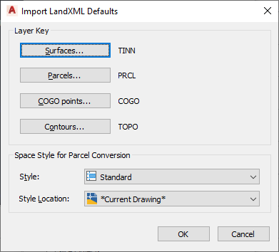

Use this procedure to set a default layer key for the different types of LandXML data being imported. You can set layer keys individually for COGO points, parcels, surfaces, and contour lines.
If you do not define specific layer keys for your LandXML data, the imported data is placed on the default layer keys specified for LandXML data, TINN (Surfaces), PRCL (Parcels), COGO (COGO Points), and TOPO (Contours).
You can also define a specific space style for parcels that are imported as spaces.
  1. Click Insert tabImport panelLand XML.
  2. Select a LandXML file to import, and click Open.
  3. In the Import LandXML Data dialog box, click Defaults.
  4. In the Import LandXML Defaults dialog box, select a layer key default for the imported objects.
    If you want to… Then…
    select a layer key default for imported surfaces click Surfaces.
    select a layer key default for imported parcels click Parcels.
    select a layer key default for imported COGO points click COGO points.
    select a layer key default for imported contours click Contours.
  5. Select a layer key, and click OK.
    If you want to import LandXML parcels as spaces, select a space style and a style location if necessary.
