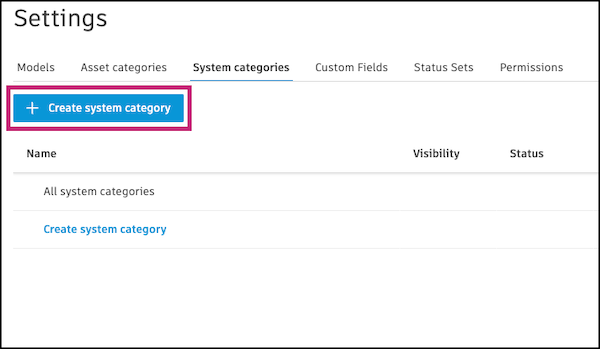

Create System Categories and Subcategories
  1. Click the Settings icon at the top-right.
    Assets Settings menu
  2. Click System categories.
  3. Click Create system category.
    System categories tab
  4. Name your category and select a status set.
    Note:
    • The Default status set contains a generic list of statuses that work in many situations. If needed, you can create your own status sets. See Configure Custom Fields and Status Sets for details.
    • Top-level system category names must be unique.
  5. Click Create and your system category will now appear in the list of categories.

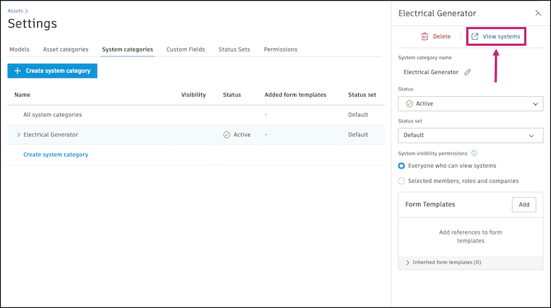

Next, you can select the category to edit its settings further.
Tip: After selecting a category, you can easily view the systems in a category. Click View systems in the right panel.
View systems in a category

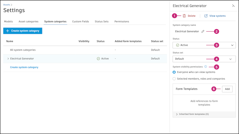

Edit System Categories and Subcategories
To edit a system category, navigate to the Assets Settings and click your category or subcategory in the System Categories tab.
In the right panel that appears, you can:
Edit system category panel
  1. Click the Delete icon Delete icon to delete the system category.
  2. Click the pencil icon Pencil icon to edit the name of the system category.
  3. Select whether a system is Active or Inactive. When a system category is active, it is available for your project members to assign to a system, but you can make it inactive to hide it temporarily.
  4. Change the status set associated with the system category.
  5. Set system visibility permissions. By default, systems will inherit any visibility permissions on the assets and subsystems within them.
    To add an extra layer of permissions, select Selected members, roles, and companies and select from the drop-down menu which members, roles, and companies can see the systems in this category.
    Note: An icon appears next to any categories in the list that have modified permissions.
  6. Add form templates to system categories. When a member adds a form reference to a system of this category, this template will appear first. This allows you to direct your team to create the specific forms that are relevant to this system.
    • Next to Form Templates, click Add.
    • Select form templates to add.
    • Click Submit.
