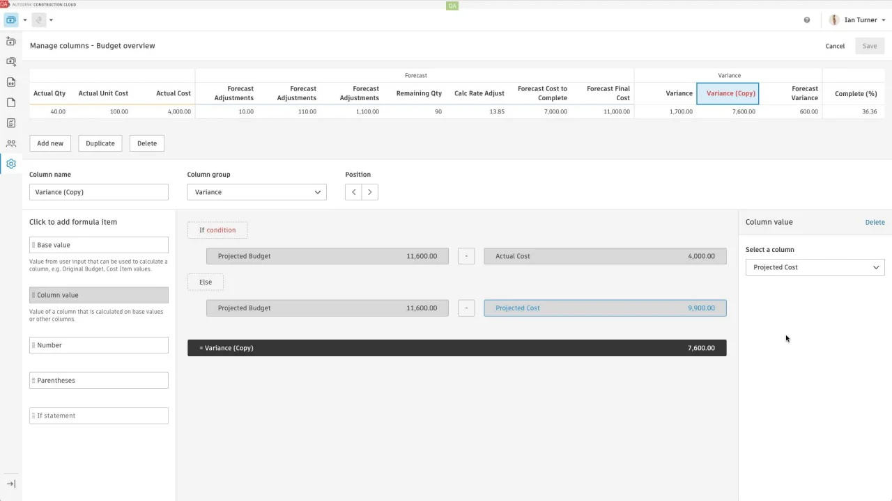

  8. From the left side panel, drag a formula item and drop it to create a formula.
    Screenshot showing the column formula builder interface with draggable items including Project Value, Existing Column, Number, Parentheses, and If Statement on the left panel
  9. On the right side panel, select the value type and enter a value to preview.
    Screenshot of the right side panel displaying value type selection and preview value input field
  10. Update the column position and visibility option.
  11. Select Save.
You have created the Recoverable Change Order column. There are many possibilities and combinations to create columns. See the Custom Calculated Columns Equations section to see helpful tips and tricks on how you can create equations to suit your company's needs.

  • If Statement: Allows you to create conditions for information to populate the column. For example, calculating the variance by the larger value projected budget minus actual cost or projected budget minus projected cost.
    Tip: You can add up to 20 If Statements by clicking the item multiple times. Each newly added If Statement will be placed above the Else Statement.
