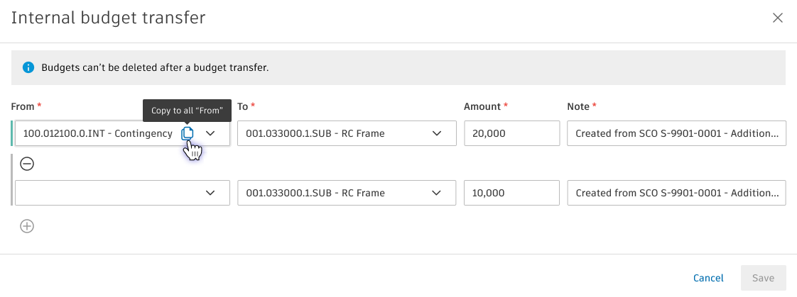

- Create an Internal Budget Transfer from PCO

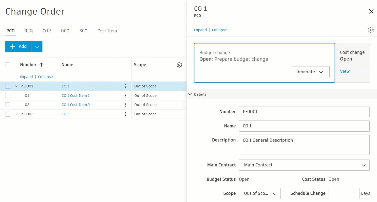

Potential Change Order Tab Overview
Select Add to create a PCO.
Select In Scope, Budget Only, Out of Scope, or Contingency to change the order's scope. When a change is budget-side only, simply do not add any values to the Estimated, Proposed, or Committed columns.
Type is an optional field if you’d like to number, track, or group change orders by their type.
Source Type and Source Ref are also optional, and you can use them to track or group based on the origin of the change.
Export allows you to export a PDF or CSV PCO report.
Column settings allow you to select the columns you wish to include in your view.
The view selector allows you to store and recall your preferred grouping or column visibility. See the Filter and Group article to learn more.

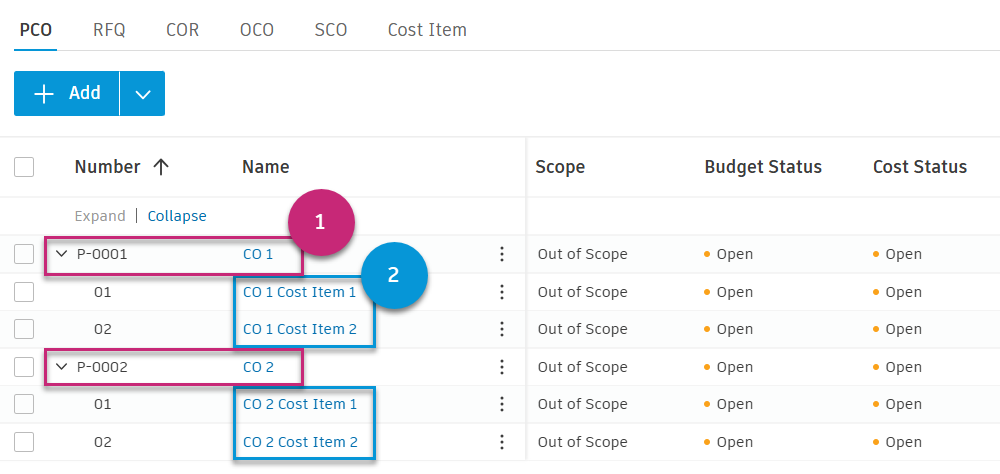

Select the PCO name to open the flyout panel and customize the details of change order. The
allows you to edit the name or the Cost Summary section lets you enter and edit Qty, Unit, Unit Cost, and Amount for each status (Estimated, Proposed, etc.).Select the More menu
to add cost items, duplicate, change status, and more.Tip: You can create up to 100 cost items at once by choosing Batch create Cost Item.

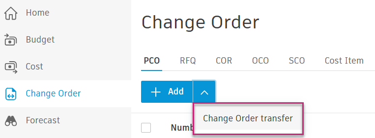

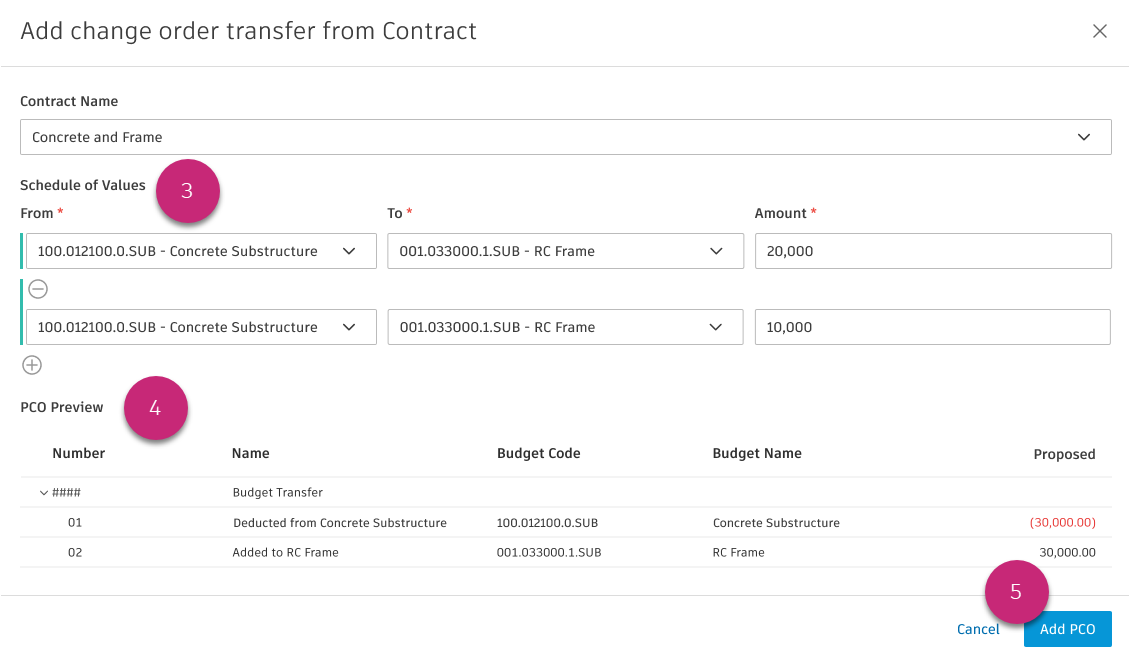

Create a PCO Through the Change Order Transfer (Collaborative PCO)
Collaborative PCO users with Collaborate permission can generate change order transfers, which are net-zero PCOs that move budget from one item to another without changing the total budget.
To create a change order transfer:
Go to the Change Order tool in Cost Management and select the PCO tab.
Click Change order transfer.
In Add change order transfer from Contract:
- If your company has only one associated supplier contract, the contract field will autopopulate.
- Use the Schedule of Values picker to select the SOV items for the transfer (only budget-associated SOV items are listed).
- Select From and To budgets to create the transfer.
Review the PCO preview showing the combination of positive and negative cost items:
- If budgets in From and To are linked to the same contract, positive and negative cost items are combined in the same PCO.
- If not, positive and negative cost items are placed in separate PCOs.
Click Add PCO.
Submit the change order transfer PCO through the normal PCO workflow. See Create a PCO as a Collaborative Access User for further instructions.

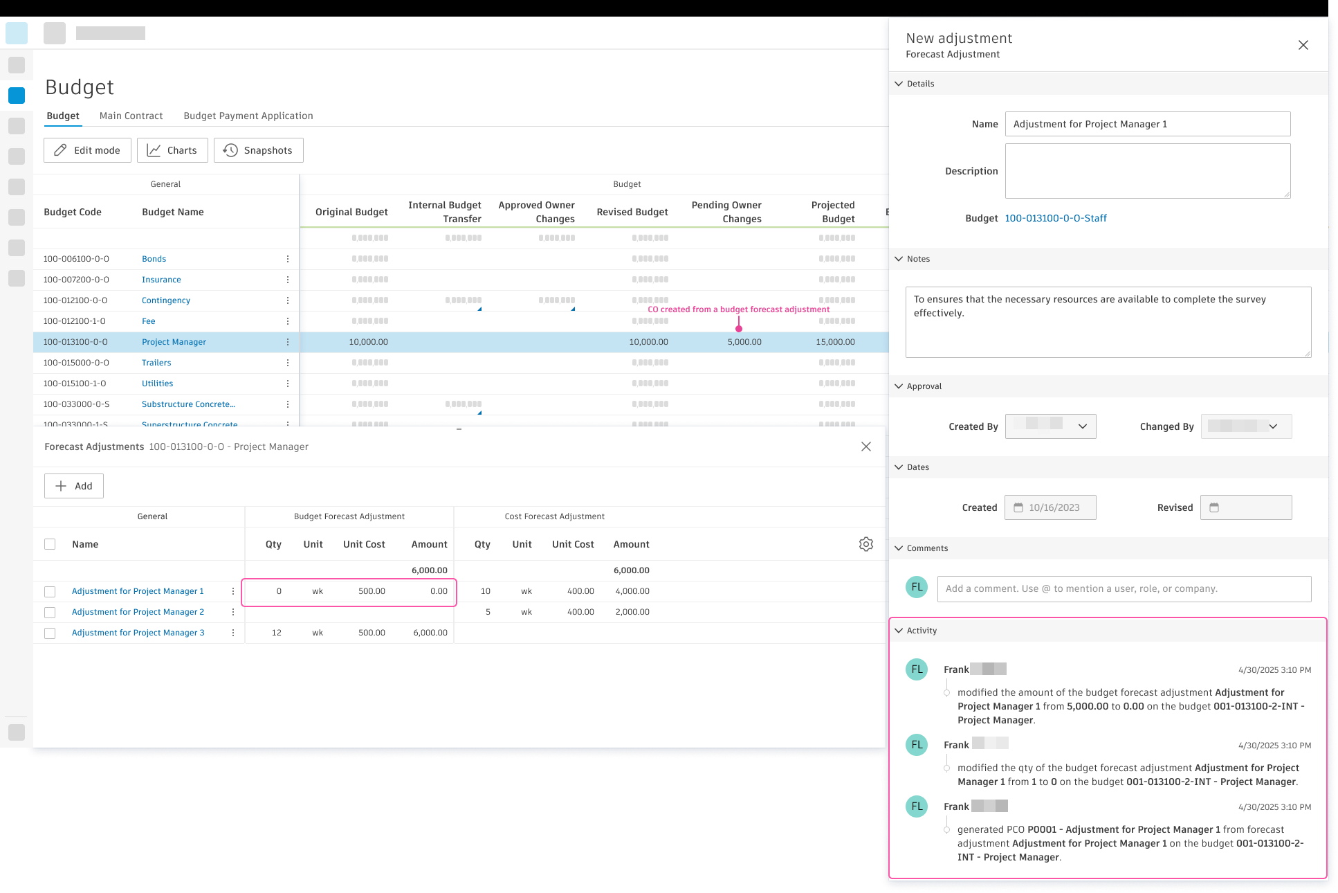

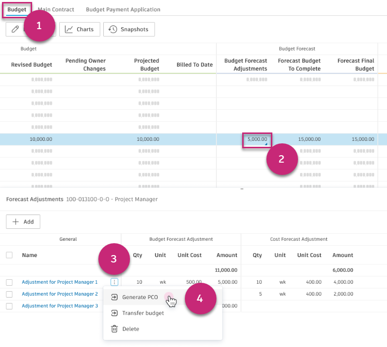

Create a PCO from Forecast Adjustment
You can create a PCO from forecast adjustment to request extra budget. This can be done when project administrator set revenue forecast.
To do so:
- Open the Budget tool in Cost Management.
- Click the blue triangle in the Budget Forecast Adjustments column in the Budget Forecast section of the table. Those are visible if revenue forecast is on. The bottom flyout opens.
- Click the More
menu next to the forecast adjustment.
Tip: You can also batch create PCOs from forecast adjustments. To do so, check all the boxes next to forecast adjustments in the bottom flyout and click Generate PCO. - Choose Generate PCO.
The Generate PCO window opens. You can generate from budget forecast adjustment, cost forecast adjustment, or both.
After the PCO is generated, you'll see changes in the Pending Owner Changes. If you generated from budget forecast adjustment, Budget Forecast Adjustment Qty is set to 0. As a result, Amount is also set to 0. Unit Cost is not changed. There are three activity logs after this procedure.
It's the similar rule for other options. If you generated PCO from cost forecast adjustment, you'll see changes in Cost Forecast Adjustment section and so on. When from both - you'll see changes in both places and there will be five activity logs.

Edit Existing PCOs
After the PCO is created, you can add more or modify details. To do so:
Click the PCO name to open the details panel.
Add information to the applicable fields in the Details, Scope of Work, and other sections, including:
- Name
- Description
- Cost Status (learn more about change order statuses)
- Schedule Change (impact of the PCO, as measured in the number of days the project schedule is changed)
- Owner Details or Main Contractor Details: The PCO scope determines which section is shown:
- Out of Scope, Contingency, Budget Only: Shows Owner Details where you select the owner company and contact
- In Scope: Shows Main Contractor Details where you select the main contractor company and contact
Modify any previously defined fields if necessary.

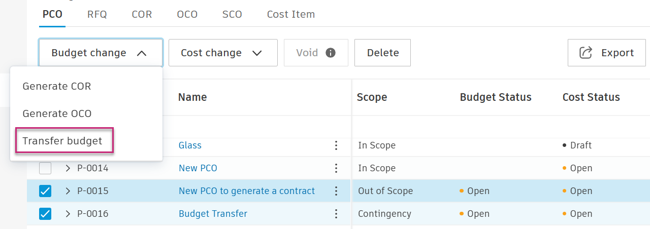

- Budget Only - click Budget Change to generate COR or OCO.
- Out of Scope or Contingency - click Budget Change to generate COR or OCO and Cost Change to generate RFQ or SCO.
Project administrators and members with both Budget and SCO full control permissions can create internal budget transfers directly from PCOs. This is useful when you need to move money from one budget item to another to pay for change orders without requiring extra approvals.
To create a budget transfer from a PCO:
Go to the Change Order tool and select the PCO tab.
You can create a budget transfer in several ways:
- From a PCO: Click the More menu
next to the PCO, click Budget change, and select Transfer budget. - From multiple items: Select multiple PCOs or cost items, then click Transfer budget in the batch actions.
Then, in Internal budget transfer:
- Each selected cost item with a non-zero Committed value creates one transfer line.
- For positive Committed values (money allocated), the system automatically uses the cost item's linked budget in the To field.
- For negative Committed values (money being removed), the system automatically uses the cost item's linked budget in the From field.
- The Amount is automatically set to the absolute value of the Committed amount.
- A note is automatically added referencing the source cost item.
Click
to add more transfers, even those that are not linked to the cost items. Those transfers are separated in the table.Click
to delete a transfer from the list. You can use Copy to all "From" or Copy to all "To" buttons to quickly populate all transfer lines with the same budget.
Click Save to create one or more internal budget transfers.
You'll receive confirmation that the budget transfer was completed.

Add Cost Items to a PCO
While you can create and work with PCOs without cost items for initial estimates, certain actions require cost items to be added. The system will guide you through adding cost items when needed.
Add cost items to a PCO before:
- Applying financial markup formulas
- Generating change orders (RFQ, COR, OCO, SCO)
- Generating contracts
Adding Cost Items
When you select Add Cost Item from the More
menu, the system displays a modal to help you add cost items:
Select budgets from the budget picker.
Choose the cost items that you want to add to the PCO.
Click Add.
The first cost item that you add will inherit the value from the PCO level, and the default cost item name will be copied from the PCO name.
If you attempt an action that requires cost items (such as applying markup or generating a change order) without having cost items attached, the system will display a modal prompting you to add cost items first with the message "Cost Item must be added before [action name]" and guides you through selecting the appropriate budgets and cost items.
