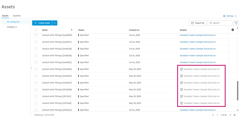

You can see if an asset is detached on the Assets tab:
  1. In the Assets tool, click the Assets tab.
  2. In the Models column, the model name is grayed out:
    This indicates that the asset is no longer attached to the model.

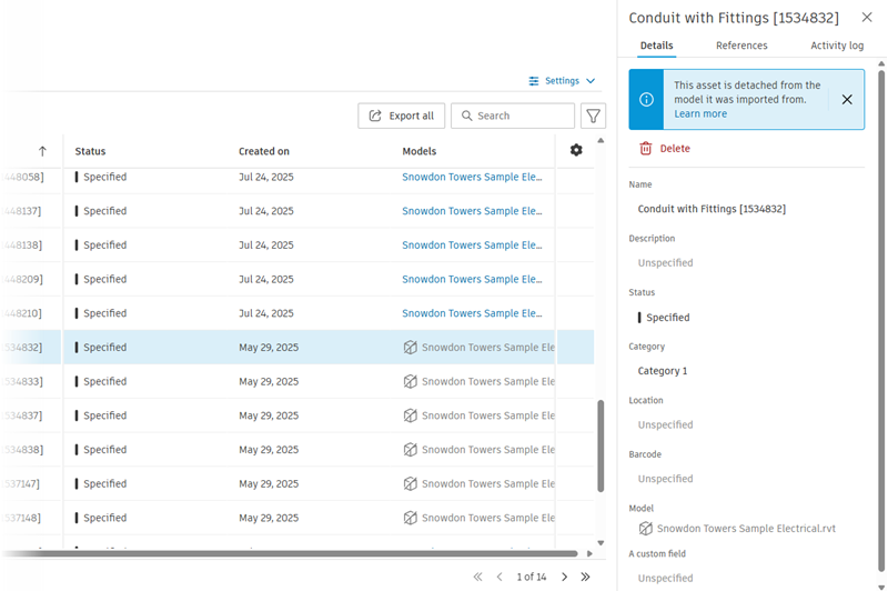

  3. Click an asset to open the Asset details panel, which confirms the asset is detached:

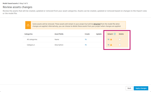

  7. Click Next to map properties.
  8. If necessary, edit the model properties that map to asset fields, then click Review changes.
    If the changes to the import rules results in existing assets being detached, the relevant numbers are displayed:
  9. Optionally, you can check the Delete checkbox next to any categories you want to delete the assets from, instead of detaching.
  10. Click Apply changes.
    Note: If you delete the assets instead of detaching them, they are removed from the project.

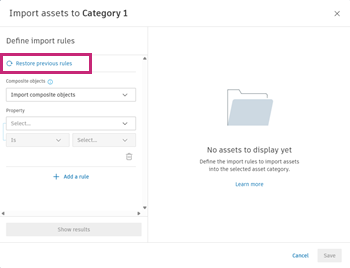

Restore import rules
When import rules have been deleted, when you return to the Import assets to category dialog, it will contain a Restore previous rules option:
  1. Click the Restore previous rules option.
  2. Click Save.
  3. Click Next to map properties
  4. If necessary, edit the model properties that map to asset fields, then click Review changes.
  5. Review the assets that will be reattached, and then click Apply changes.
