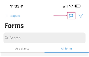

  1. Open a form in the Forms tool in the Autodesk Construction Cloud app.
  2. Tap comment icon at the top.
  2. Tap comment icon icon at the top right.
A list of all the form comments, including who made them, on what form, and when, will appear.
Tap on a comment to view all the comments from the relevant form. Tap See form at the top right corner to navigate to the form itself.
Any unread comments will be marked and you can tap Read all to mark all comments as read.
