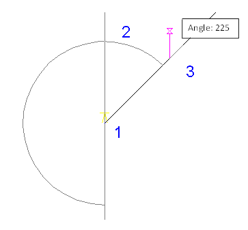

When creating an object, such as a line or an arc, you can specify a point by specifying azimuth and distance from another point. Azimuth is the clockwise angle from the North (or South) meridian.
Select a starting point (1). Then specify the azimuth angle (2) and the distance from the starting point (3).
To specify a point using azimuth and distance
