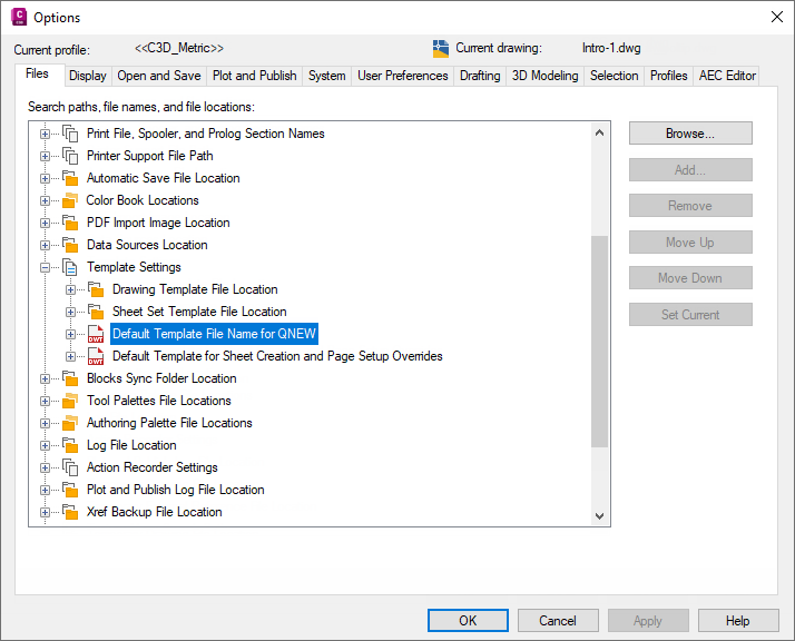

To change the default template
- Enter Options at the command line.
- In the Options dialog box, on the Files tab, expand Template Settings.
- Change the value for Default Template File Name for QNEW to the template that you want to use.
Figure 1: Set the default template
