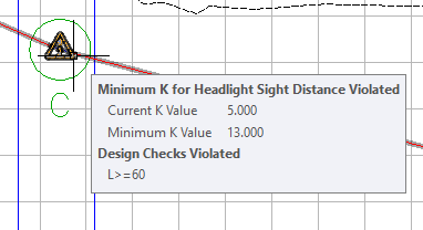

  3. Hover the cursor over the symbol in Circle C.
    The tooltips are a convenient way to review design criteria violations in the drawing window. Two violations are displayed in the tooltip:
    • First, the curve does not meet the recommended minimum K value for headlight sight distance. The curve K value and minimum acceptable K value are both displayed.
    • Second, the curve does not meet the formula specified in one of the design checks. Notice that the name of the design check is displayed, but not the current or recommended values. Values are not displayed because design checks are custom formulas that are created by the user.
