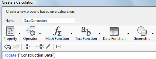

To convert a data value to a different format
- Select the command for which you want to create an expression.
- In the expression area, select the conversion type you want from Conversion.
For a complete list, see Conversion Options.
- Click Property and select the property to convert.
- Specify any further arguments or values required by the conversion.
Some conversions let you specify the format of the converted string. For example, if you convert a text string to a date format, you can specify how the date value appears. For more information, see Date Formatting Options.
Use conversions to change the format or type of a string property.
For help with any expression element, see Creating Expressions - Reference.
- Click OK to apply the expression.
