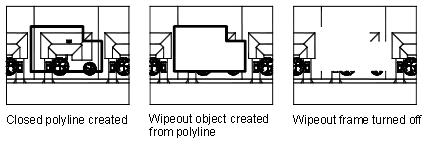

A wipeout object is a polygonal area that masks underlying objects with the current background color. The wipeout area is defined by the wipeout frame, which you can turn on for editing and turn off for plotting.
