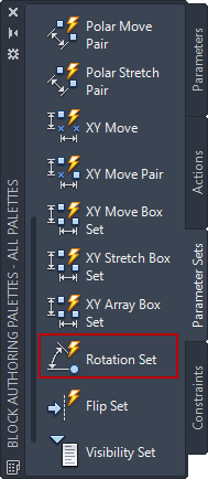

  2. Define the rotation property.
    • On the Block Authoring Parameter Sets palette, click Rotation Set.
    • Right-click the resulting parameter and click Properties.
      You can also type PROPERTIES at the Command prompt.
    • In the Properties palette, under Property Labels, change the Rotation Set to Map.View.Rotation.
      AutoCAD Map 3D toolset uses this parameter to calculate the angle of the north arrow.
    • To avoid displaying this property, under Misc in the Properties palette, change Show Properties to No.
    • To avoid displaying the grips for this property, change Number of Grips to 0.
