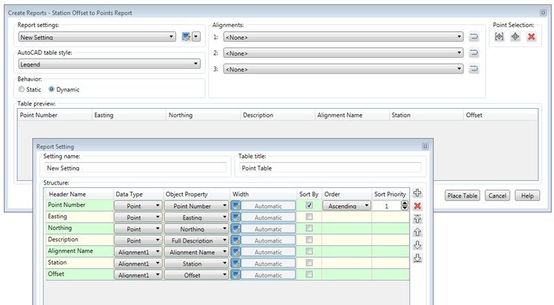

  • Create Point-Alignment Table command: Opens the Create Reports - Station Offset to Points Report dialog box. This dialog box presents the default COGO point location table template. The table lists point number, easting, northing, description, alignment name, station, and offset.
  • Edit Point-Alignment Table command: Opens the Create Reports dialog box for the table report you select in the drawing. The settings for the current report are displayed in the table preview area.
    • You can edit variables directly in the Create Reports dialog box, such as selecting different points to include or changing the alignments.
    • To change the table structure itself, click in the Create Reports - Station Offset to Points Report dialog box to open the Report Setting dialog box.
