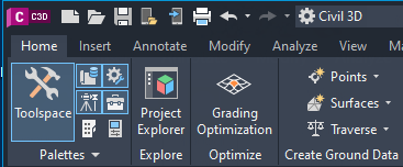

Access the Project Explorer window can be accessed from the Home tab of the main Autodesk Civil 3D ribbon.
