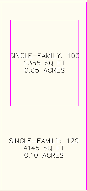

If you create a parcel from a closed area, such as a polygon that is fully enclosed in a parcel, the smaller area will be subtracted from the total area of the larger parcel. You end up with two parcels, with one being an island parcel inside of the other as shown in figure 1.
Figure 1: Enclosed parcel subtracts area from larger parcel
