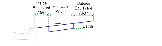

This subassembly inserts links for a concrete sidewalk with inside and outside grass boulevards.
The attachment point is at the inside edge of the inside boulevard. The UrbanSidewalk subassembly is typically attached to a back-of-curb or edge of pavement.

Behavior
The inside grass strip, sidewalk, and outside grass boulevard links are inserted outward from the attachment point at the given slope. The grass strips can be omitted by specifying a zero-width.
Optionally, various element widths can be attained by attaching to offset alignments. Also, the sidewalk cross slope can be derived by tying into an offset profile.

Layout Mode Operation
In layout mode, this subassembly displays the boulevards and sidewalk based on the input parameter values given.
