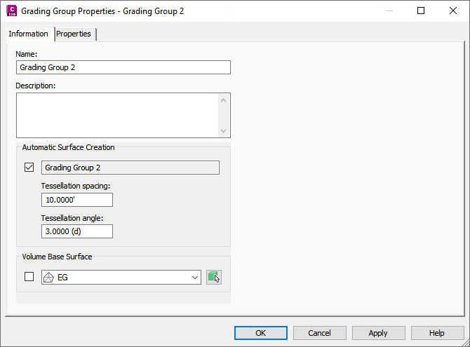

To fix the arc triangulation, we need to set a finer value for tessellation spacing in the grading group. As shown in figure 26, this can be difficult to find in the Grading Group Properties dialog box, because it can be set only when Automatic Surface Creation is enabled. However, this setting is also used for the Create Detached Surface command and infill grading triangulation. The best solution at this point is to turn on Automatic Surface Creation, change the tessellation spacing from the default value of 10 feet to 1 foot, then turn off Automatic Surface Creation again. You must click Apply after turning on Automatic Surface Creation in order to apply the changed settings.
Figure 26: Changing tessellation spacing
