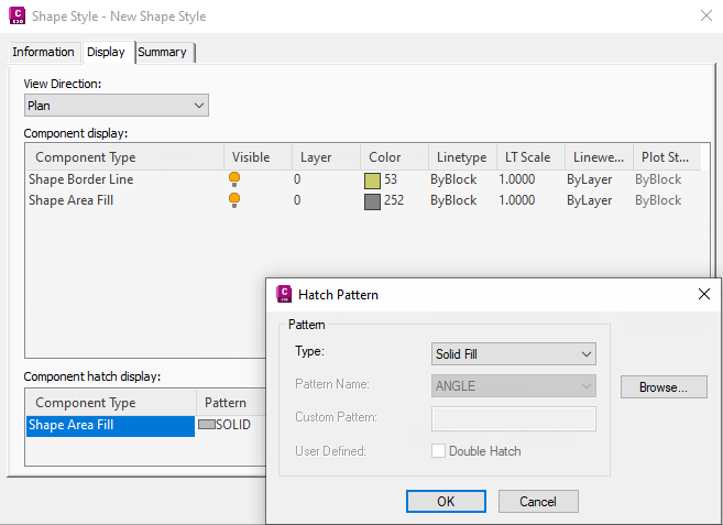

When designing corridors, you can create more efficient subassemblies by ensuring that the shape style for each one is defined with no fill, or at least with a solid fill rather than hatch patterns. Figure 2 shows the Shape Style dialog box, where you can define a subassembly shape style.
Figure 2: Editing a subassembly shape style

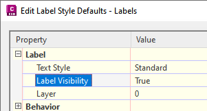

To turn off all labels for a feature:
  1. Right-click the feature node on the Toolspace Settings tab.
  2. Click Edit Label Style Defaults.
  3. In the Edit Label Style Defaults dialog box, set label visibility to false, as shown in figure 3.
Figure 3: Turning off label visibility for a feature

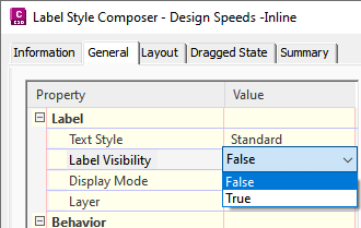

If you want to create a label design that has just the essential data and can be drawn quickly, simplify all text and graphic elements, including the use of rotation, borders, and plan readability. Another useful tactic is to leave a style in place, but temporarily edit the style with the Label Style Composer to turn off the label visibility, as shown in figure 4.
Figure 4: Turning off label visibility

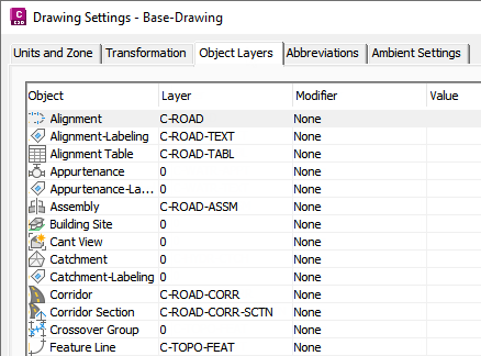

For faster processing, freeze or turn off the drawing layers that contain objects. By default, design objects and their labels are divided across multiple layers. For example, as shown in figure 5, alignments, profiles, and other road design objects are spread across many layers, all beginning with C-ROAD. If you consolidate the road design objects on fewer layers, it is easier to turn them on or off.
Figure 5: C-ROAD layers
