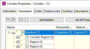

Multiple Regions for Corridors
With long corridors or corridor networks, create multiple regions for modeling purposes. Normally, corridor regions are used to mark the use of different assemblies, with a region boundary occurring where the use of one assembly ends and another begins. But you can also add regions without changing assemblies. The value of additional regions is control—you can use the Corridor Properties dialog box to turn off the modeling of regions not required for current operations, as shown in figure 13. This improves the speed of corridor rebuilding.
Figure 13: Turning off corridor regions and baselines
If your corridor includes some regions with few changes in the surface or the assembly, consider reducing the frequency of the corridor modeling in these regions to improve processing speed.
