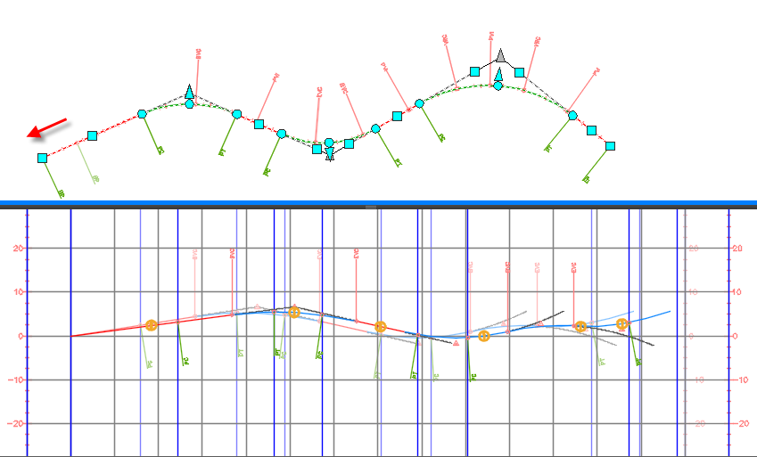

The following illustration shows an alignment (upper viewport) and its associated profile (lower viewport).
In the following example, the Anchor Profile Geometry Points To Alignment Geometry Points option is specified for the profile. When the start point of the alignment is grip-edited to the left (indicated by the red arrow in the illustration below), making the alignment longer, the profile is modified and the modified geometry is marked with notification symbols. The original drawing is inserted as an xref so that you can see how the alignment and profile are changed by the edit. The xref shows the original geometry in lighter colors.
There may be situations where a solution cannot be found for the profile geometry when the alignment is edited. In this case, when a solution cannot be found, the profile entities will be deleted, creating gaps in the profile. If the profile geometry is broken to create a gap, it is broken at the nearest vertical geometry point that is outside the affected region.
