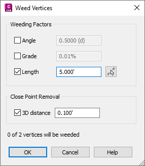

- Use the Weed command (WeedFeatures) to remove unnecessary points and simplify grading geometry where possible. This operation can significantly improve the results where two or more gradings intersect.

Removing Unnecessary Points
Figure 16 shows the dialog box for configuring the weeding operation. You can specify the weeding factors to apply, adjust the numeric values, and preview the results before committing. Click the Help button on this dialog box to see the Help topic for weeding and learn how to use these controls for best results.
Figure 16: Weeding controls
