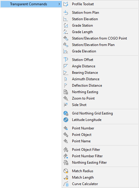

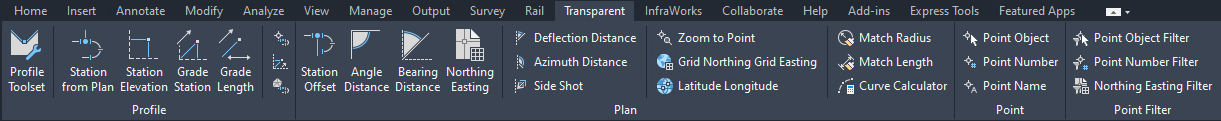

You can run transparent commands from the Transparent ribbon tab, from the context menu, by using a toolbar, or by entering a command.
  • Select the command from the Transparent ribbon tab.
  • Select the command from the Transparent Commands context menu.
  • Select the command from the Transparent Commands toolbar.
  • Enter the name of the transparent command at the command line. A transparent command always begins with an apostrophe (‘).
