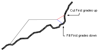

Specifies whether to search first for cut or fill slopes in cases where both would work. For example, where the target surface has a steep slope, both cut and fill slopes may intersect the surface.
  • Cut First: Creates the grading by trying to grade up from the footprint. If no solution is found, it will grade down.
  • Fill First: Creates the grading by trying to grade down from the footprint. If no solution is found, it will grade up.
Different results achieved based on Cut First and Fill First settings (section view)
Note: Technically both of these situations are “fill”. However, Autodesk Civil 3D treats the up-slope direction as cut and the down-slope direction as fill.

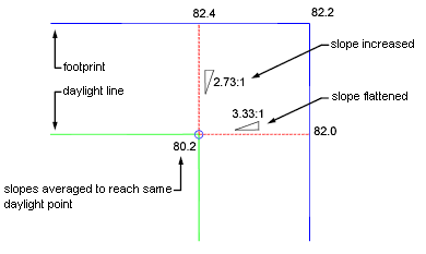

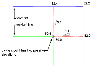

Specifies how interior corner projections are cleaned up when the footprint corner has different elevations. This situation results in two possible daylight point elevations. You can choose to average the slopes to reach the same point, or increase or decrease one of the slopes.
Corner elevation conflict (plan view)
  • Use Average Slope: Averages the slopes to reach same daylight point.

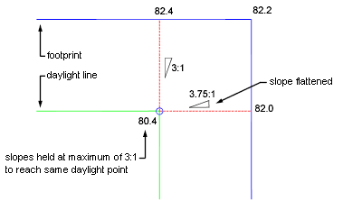

  • Hold Slope As Maximum: Holds the specified grade or slope as the maximum and flattens out the slope projected from the footprint on one side.

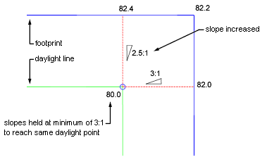

  • Hold Slope As Minimum: Holds the specified grade or slope as the minimum and increases the slope projected from the footprint on one side.
