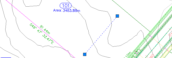

  1. In the left viewport, select the 3D polyline in parcel 101.
  2. On the command line, enter LIST.
    In the AutoCAD Text Window, notice that the elevation values for the polyline vertices are approximately 38.
  3. Press Enter. Close the AutoCAD Text Window.
  4. In the right viewport, select the 3D polyline that crosses between stations 0+060 and 0+080.
    When you select the 3D polyline in the profile view, notice that the 3D polyline in plan view is highlighted.
  5. Drag the left grip down toward the bottom of the profile view.
  6. Repeat Steps 1 and 2 to examine the new elevation value.
    When you grip edit a projected feature line or 3D polyline, the corresponding elevation of the source object is adjusted.
  7. Press Enter. Close the AutoCAD Text Window.
