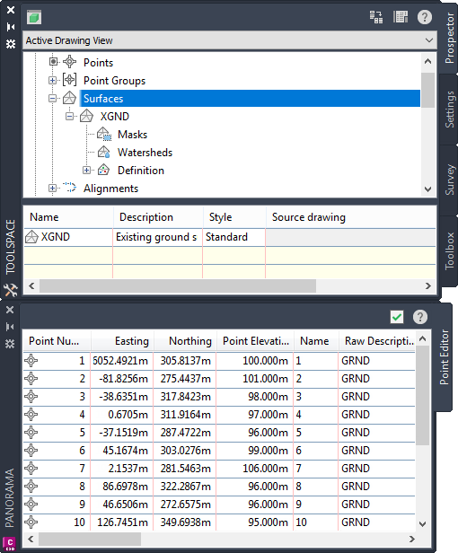

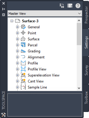

Tabs
The Toolspace window can display up to four tabs: Prospector, Settings, Survey, and Toolbox. The Panorama window displays named tabs if you have more than one vista active in the window.

The following illustration shows the Toolspace window both closed and open, with Auto-hide active:
Closed Open
To activate Auto-hide for the Toolspace or the Panorama window, click on the title bar. To deactivate Auto-hide, click on the title bar. You can also right-click the title bar and use the context menu to control Auto-hide. For more information about Auto-hide, see the AutoCAD Help.
