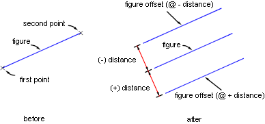

You can offset an existing figure by a specified distance. A positive value indicates an offset to the right; a negative value indicates an offset to the left.

The following illustrates the Offset Figure command:
Command Syntax
OFFSET [figure] [distance]
Command Synonym
OFFSETS
Parameter Definition
figure The name of the figure you want to extend.
distance The offset distance from the current point. Enter this value in the current survey database distance units.
