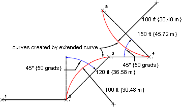

The following illustrates two non-tangential curves:
