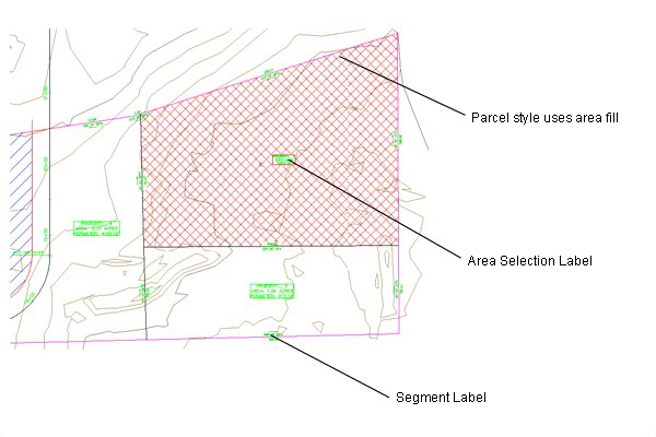

There are separate label styles for parcel areas and parcel segments.
Parcel display style and two types of label
