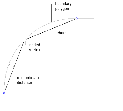

When creating a boundary, you set arc tessellation and specify whether the boundary uses non-destructive breaklines.
Arc Tessellation
When you use polygons/polylines that contain curves for boundaries or breaklines, set the mid-ordinate distance of the chord segments, which is used to tessellate the arc segments of the boundary polygon/polyline:

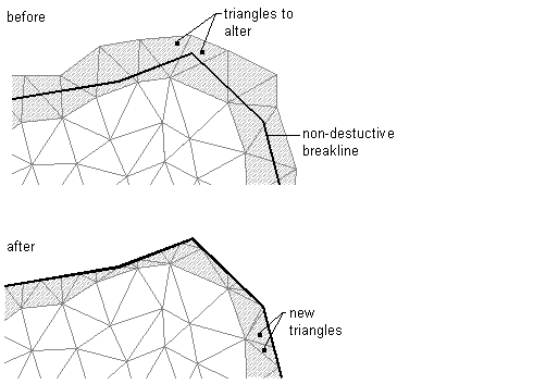

Non-Destructive Breaklines
Specify whether a boundary uses non-destructive breaklines when you create it by selecting Non-destructive breaklines in the Add Boundaries dialog box.
Note: You cannot add non-destructive breaklines to a grid surface.
When you create a boundary with non-destructive breaklines along the edges of the boundary, the triangle edges are clipped exactly where they cross the boundary:

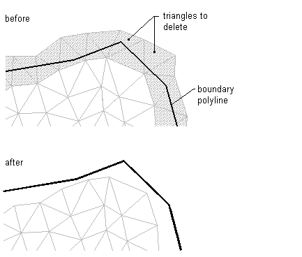

If you create a boundary without non-destructive breaklines along the boundary edges, only triangles that are completely within or outside the boundary are affected:
