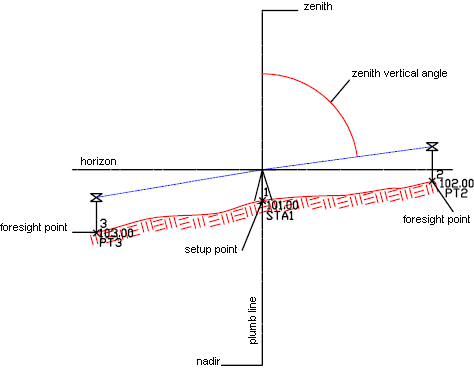

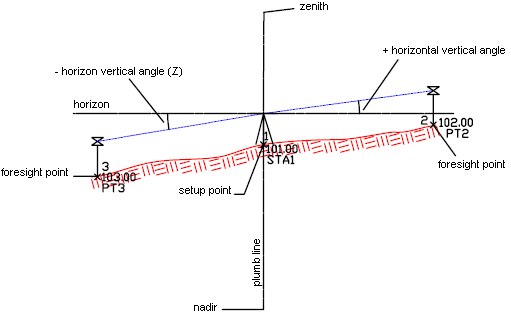

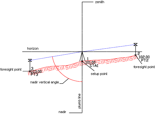

- vertical angle
An angle above or below the horizontal plane. The angle is expressed in DDMMSS from this horizon. Vertical angles expressing a downhill slope from the instrument station are described with a negative value. Zenith angles are similar to vertical angles, except that a zenith angle has a vertical reference plane.

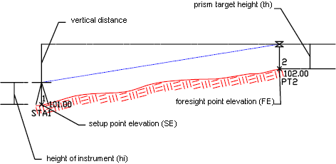

- vertical distance
A distance measured along a sloped surface. For example, if you measure a distance from point A to point B that is on a 3:1 grade, then that distance is longer than the distance measured horizontally.

- zenith angle
The point directly overhead or the point where an observer's vertical line pierces the celestial sphere. Opposite zenith is the nadir.
