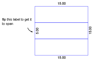

The parcel segment to label with the span must be one unbroken entity. For example, in the tutorial drawing Parcel-3.dwg, you can see that the top of the parcel group is one segment, so a span label can be successfully applied.
However, the left side of the parcel group is broken up into three segments, as shown below. The span label will not label all three. If you want to label the overall distance of that side, you would need to redraw the left side as one parcel entity.
