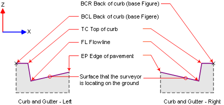

The following illustration shows an example of feature definitions:
The following illustration shows these feature codes:
  • 1: BC (back of curb)
  • 2: TC (top of curve)
  • 3: FL (flow line)
  • 4: EP (edge of pavement)
  • 5: CL (centerline of existing roadway)
  • 6: Point located in the field by a surveyor
