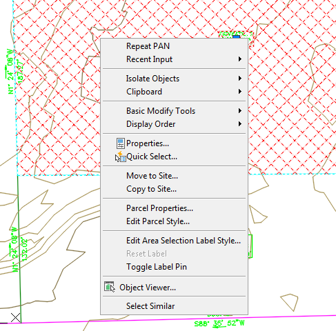

The parcel area selection label is an embedded object that cannot be deleted, as it is used to select a parcel. The parcel area selection label is distinct from other parcel area labels. The area selection label and other parcel labels are all supported by the AutoCAD Properties palette. To edit the parcel area selection label, right-click and select Edit Area Selection Label Style as shown in figure 12.
Figure 12: Parcel area selection label context menu
