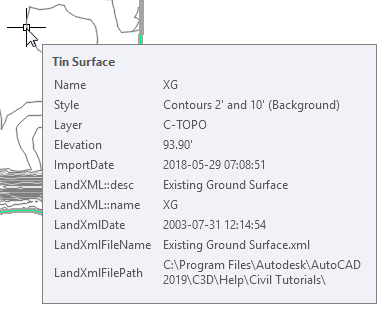

To create and apply property set definitions when importing LandXML surface data
You can specify whether property set definitions are created and applied when surface data is imported from a LandXML file. For more information, see Import Tab (LandXML Settings Dialog Box).
You can view this property set data in the AutoCAD Properties Palette and in tooltips.
  1. Configure the LandXML import settings so that property set data is created.
  2. Import a LandXML file that contains one or more surfaces.
  3. Click Manage tab Property Set Data panel Define Property Sets Find.
  4. In the Style Manager dialog box, expand the drawing name Documentation Objects Property Set Definitions collection.
    The following property set definitions may be created, depending on the import settings and file content:
    • Imported LandXML File
    • LandXML Attributes [AeccDbFeatureLine]
    • LandXML Attributes [AeccDbSurfaceTin]
    • LandXML Attributes [AcDb3dPolyline]
    • LandXML Features [AeccDbFeatureLine]
    • LandXML Features [AeccDbSurfaceTin]
    • LandXML Features [AcDb3dPolyline]
