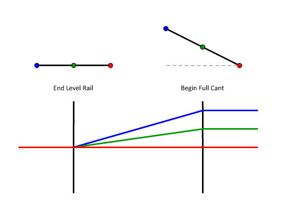

Pivot at Low Side Rail
The following illustration describes the Low Side Rail pivot method for a single track railway.

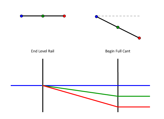

Pivot at High Side Rail
The following illustration describes the High Side Rail pivot method for a single track railway.

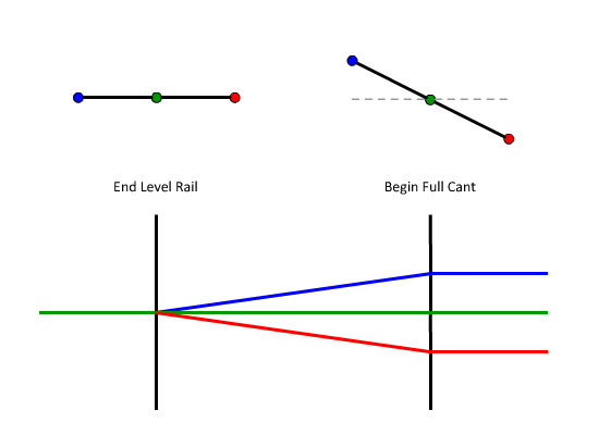

Pivot at Center Baseline
The following illustration describes the Center Baseline pivot method for a single track railway.
