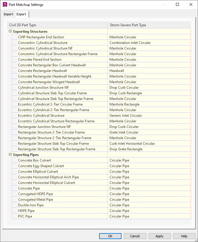

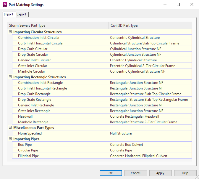

The Part Matching Defaults settings are found in the Feature Settings for Pipe Networks under Storm Sewers Migration Defaults.
Most users find that they get the best results when the Export matchup settings are equivalent to the Import matchup settings. Otherwise, a different Part Family will be substituted upon import.
The Export tab as shown below enables you to select any of the available Storm Sewers Part Types (on the right) to match to each of the Autodesk Civil 3D Part Types found in the current Part Catalog. The Autodesk Civil 3D Part Types that are shown are updated based on changes made to the Part Catalog.
The Import tab enables you to select an Autodesk Civil 3D Part Family (on the right) to be used for each available Storm Sewers Part Type. The Storm Sewers Part Type is a fixed list. This mapping should be equivalent to the export mapping so that part families remain the same.
Most new structures in Storm and Sanitary Analysis will export as a rectangular shaped 4 foot by 4 foot structure in the STM file and may not match the same part types that were originally imported as circular structures (if Use Imported Part ID for Part Family is set to No). One possible practice would be to have rectangular Storm Sewers Parts and circular Storm Sewers Parts map to the same Autodesk Civil 3D Part Type, although if the setting are configured with that strategy, a one-to-one mapping between Storm Sewers Part Type and Autodesk Civil 3D Part Type will not be possible.
The matching of STM Part Type to Storm and Sanitary Analysis Part Type is hard-coded. The following table shows how Storm and Sanitary Analysis uses the values. Reading from left to right shows the STM part types, how they are imported into Storm and Sanitary Analysis, and then how those are exported back to the STM file:

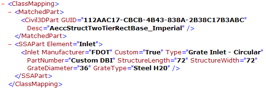

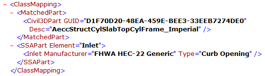

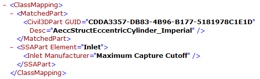

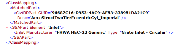

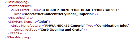

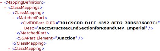

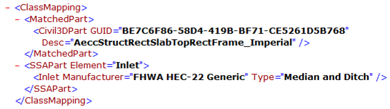

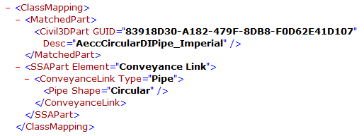

The XML Part Mapping Files
If you need to have more control over part mapping, you can set up an XML part mapping file.
When you use an XML part mapping file, the part mapping is done using the Part ID included in the STM file. The XML part mapping file creates a specific mapping between Autodesk Civil 3D and Storm and Sanitary Analysis parts based on Part ID, so specific matches can be made.
The XML part mapping file is editable and is intended to be used by advanced users to map Autodesk Civil 3D parts to specific Storm and Sanitary Analysis part configurations. The XML part mapping file has a separate format for different element types.
Sample XML Part Mapping Files and Schema Definition File
The default XML part mapping file is installed to the following folder:
C:\ProgramData\Autodesk\SSA <version>\Support\SSA_Mapping_Definition_Civil.XML
Note: The part mapping file must exist in the above location and must be named the same as the default file. You can swap out the XML part mapping file with other versions of the file by backing up the original file and replacing it with a different version of the file, perhaps for different customer projects or projects for different approving authorities. Local, State or County agencies may want to use this Part Matching file.

The following examples show Autodesk Civil 3D parts that are matched to different types of Storm and Sanitary Analysis parts. The bold items are the attributes that should be edited to make the proper matching. The items in red are the schema tag names and would likely not change for the same element type.
This format could also be used for most of the other elements, except Inlets and Conveyance Links. For example, you could replace "Junction" with the desired element type, such as "Storage", "Outfall", "FlowDiversion", and so on.
Junctions (or other nodes)
Combination Inlet
Curb Inlet
Grate Inlet
Maximum Capture Cutoff
Median & Ditch Inlet
Conveyance Link: Pipe
The Conveyance Link Type could include: Pipe, Open Channel, Culvert, or Direct.
The shape will vary depending on the type chosen (refer to available shapes for each type inside Storm and Sanitary Analysis.)

Special Case: Custom Inlets
The Inlet element in Storm and Sanitary Analysis is a special case since there are additional "dimensional" attributes that could be used to map to a more specific cataloged part. More information is available in the SSA_Mapping_Definition.docx file mentioned above. Be sure to use the appropriate attributes for the specific part in Storm and Sanitary Analysis that you are mapping to.
Example: (this example maps to a custom FDOT circular grate with custom attributes)

  2. Open the Pipe Network Feature Settings dialog box and examine the Part Matchup Settings. On the Export tab:
    • The Concrete pipe is mapped to Circular Pipe
    • The HDPE pipe is mapped to Circular Pipe
    This means that both pipe types will be exported to the Circular Pipe type.
  3. On the Import tab, under Importing Pipes, Circular Pipes can only match to one type, "Concrete Pipe."
    This means that by default, circular pipes that are not concrete, such as the Corrugated HDPE pipe, will be switched to Concrete on import. The following example shows how to set up the XML part mapping file so the pipe type is retained on import.
