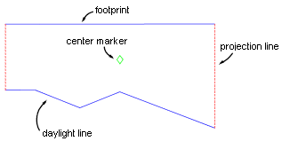

A grading normally consists of the footprint, the daylight line, the projection lines, and the face.
The footprint can be an open or closed figure. The footprint must be either a feature line, a lot line, or the resulting daylight line of another grading.
The face is the area bounded by the lines that define the grading. It is marked with a center marker.
The target for the grading can be a surface, a distance, an elevation, or a relative elevation.
Plan view of grading

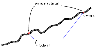

    Surface as target (section view)

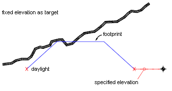

    Fixed elevation as target (section view)

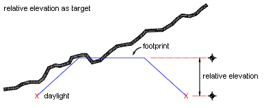

    Relative elevation as target (section view)
