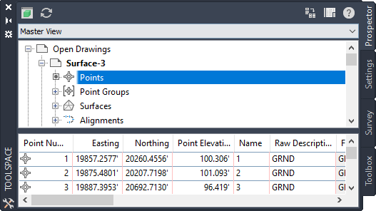

List View
A list view is a table displayed by the Toolspace trees for some items. In some cases, this information can be edited. The following illustration shows a Prospector list view of points:
When the Toolspace is docked, the list view is displayed below the data tree. When the Toolspace is undocked, you can display the item view either below the data tree or to one side of the data tree by clicking the item view orientation button .

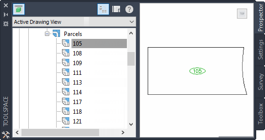

Graphical View
A graphical view displays an image of the selected item. The following illustration shows a Prospector graphical view of a parcel.
To view graphical item previews, you first click the Item Preview button on the Prospector tab. Then right-click the object or object collection and select Show Preview. Then click on the object name in the Prospector tree.
Right-click in the graphical preview to display a context menu that allows you to manipulate the image using commands such as Pan and Zoom.
