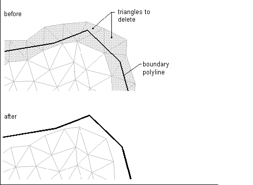

A boundary is a closed polyline that defines the visibility of surface triangles within it. A boundary can hide all triangles outside it, hide all triangles inside it, or show triangles inside it that would otherwise be hidden. Boundaries also change surface statistics such as area and number of triangles. Boundaries can either be “destructive” (totally hiding triangles that cross the boundary) or “non-destructive” (clipping triangle edges at the point where they cross the boundary). Normally, TIN surfaces use non-destructive boundaries, while grid surfaces can only have destructive boundaries:
Non-destructive Boundary
