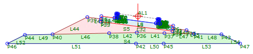

To ensure that cant is calculated correctly when the subassembly is used in Autodesk Civil 3D, and previewed correctly in the Subassembly Composer, ensure that the origin in the Preview panel is at the center point between the left rail top point and the right rail top point, as shown in the following illustration:

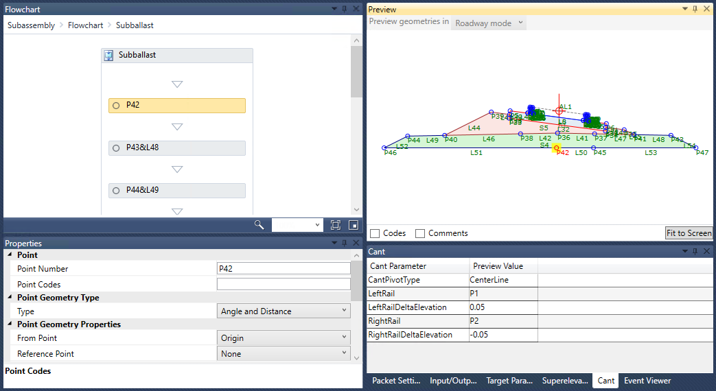

  • A GaugeWidth parameter has been specified on the Input/Output Parameters tab.
  • Values to show in the Preview panel are specified on the Cant tab.
In this example, ApplyAOR is specified for one auxiliary link, AL1, and subsequent points and links that are expected to have a cant effect are made directly or indirectly dependent on AL1 or its points.
Subsequent points and links in the flowchart that are not expected to have a cant effect can be directly or indirectly defined in relation to the origin point (or on points or links that are not directly or indirectly dependent on AL1 or its points).
For example, P42, in the subballast, is defined in relation to the origin and does not have a cant effect.
