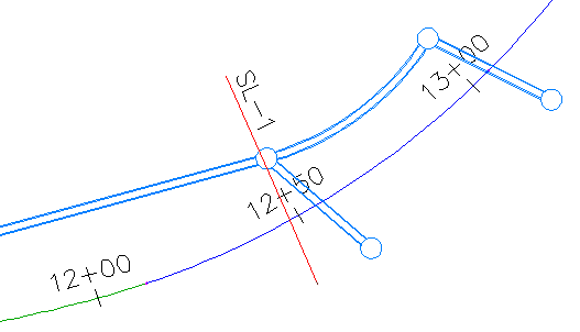

The following illustration shows the pipe network and the sample line crossing through a structure and a pipe.

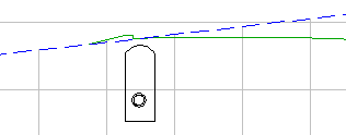

The following illustration shows the pipe network components displayed in a section view. In this illustration, the sliced solids options are not applied to the structure or pipe network style. Note that the structure is represented as if the sample line crosses it in the middle of the structure.
