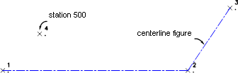

In the following example, the beginning of this command sequence describes how to draw the centerline figure.
BEGIN CL1
NE 1 1000 1000
NE 2 1000 1500
NE 3 1300 1700
END
NE 4 1100 1100
CL IS CL1 500 4
! Figure CL1 is the current centerline.
! Start Station: 400.00 End Station: 1260.56
Figure CL1 is the current centerline. Assigning Point 4 a station of 5+00 results in the centerline starting at station 4+00.
