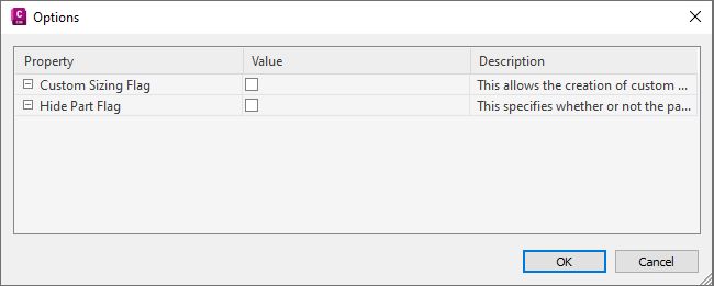

- On the Part Builder toolbar, click Options.
The Options dialog box is displayed.
- Make sure the check box in the Value column for the Custom Sizing Flag property is unchecked, and that the Hide Part Flag property is checked, then click OK.
In the part browser, Autolayout Data is added to Modeling, and trim length points are displayed on the model in the modeling area.
