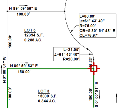

  5. Specify a Point of Beginning. The interactive graphics display the POB in the drawing.
    Note: Colors displayed in the temporary graphics are controlled by the Mapcheck command settings.
    The following illustration shows the Point of Beginning:

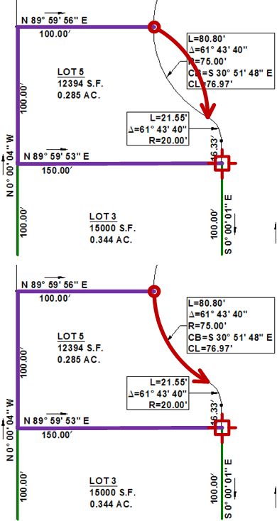

  6. At the command line you are prompted to select a label. After selecting a label, the interactive graphics display in the drawing. If you need to make a change, at the command line you have options to do the following:
    • Clear: Clears the current side.
    • New: Starts a new mapcheck report.
    • Flip: Changes the direction of the curve to either clockwise or counter-clockwise.

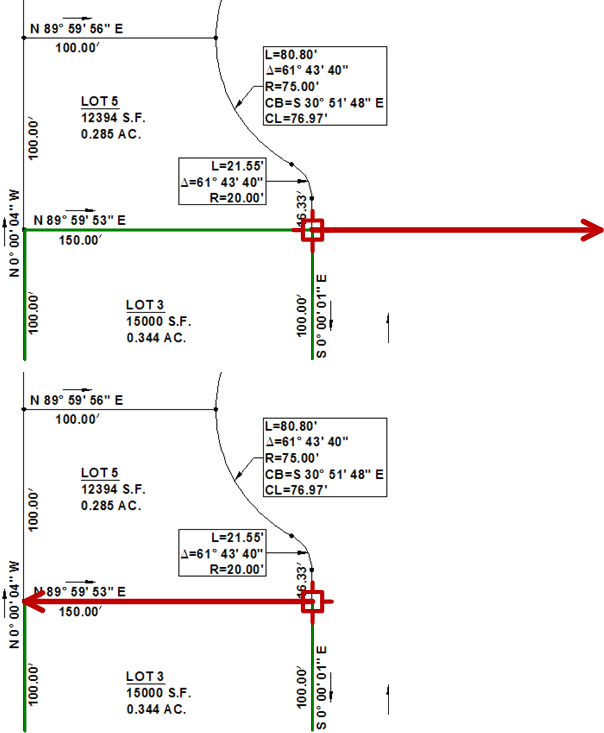

    • Reverse: Changes the direction of the line or curve.
    Note: If the mapcheck requires more information to make the calculation, a red circle displays in the drawing and you are prompted at the command line.
    The following illustration shows how the Reverse command can be used to change the direction of the mapcheck line:
    The following illustration shows an example of using the Flip command:
