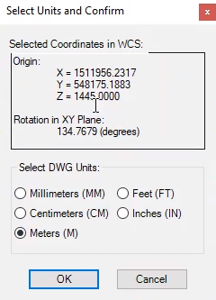

- Select the origin point and then select a second point at the same elevation. Note that these points will also need to be selected in Revit in the same order as in Civil 3D.
- In the Select Units and Confirm dialog box, select the drawing units. Click OK.
- Specify a location for the file and click Save.
