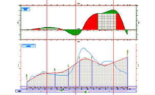

Using the Create Mass Haul Diagram wizard, you can create a mass haul diagram with a single click, accepting the default settings for name, style, display, and balancing options.
You must have a material list for the drawing before you can create a mass haul diagram. A mass haul diagram (top) can be mapped directly to a profile view (bottom) created from the same alignment.
