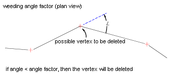

Reduces the number of vertices generated along the best fit entity. The weeding factor ignores vertices that deflect less than the Angle Tolerance. A larger deflection angle weeds a greater number of points. The Angle Tolerance is measured in angular units. The Angle Tolerance must be less than the supplementing Distance.
Angle Tolerance
Specifies the weeding angle factor.
