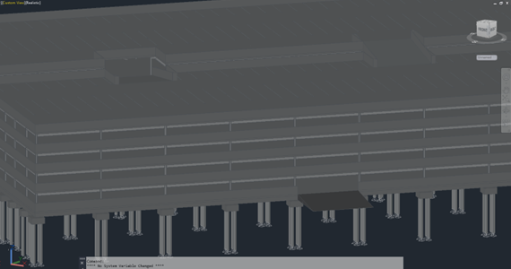

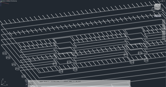

  • IFC 4.3 Extension for Civil 3D supports a small subset of 2x3 geometry. The following example of a car park IFC 2x3 coordination view exported from Revit.
    Import from IFC tool
    IFCImport command
