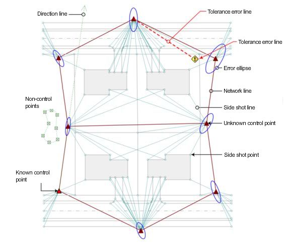

A survey network is a series of interconnected lines that represent the observed instrument setups, or stations. It contains all associated known control points, known directions, setups, and observations.
Tip: Use the Import Survey Data command to create a network and import data using the wizard interface. For more information, see Import Survey Data Wizard.
After you have imported or created data in the survey network you can insert the network into your Autodesk Civil 3D drawing as a network object.
The following illustration shows the network components:
